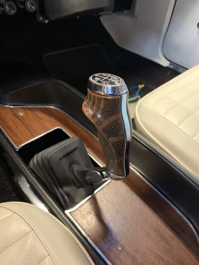

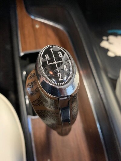

I am in the process of replacing my old worn out 4-speed Hurst Pistol Grip on my '71 Roadrunner. As you can see from the pictures, the lens on the old one has a cracked bezel... the older grip was pretty faded too.

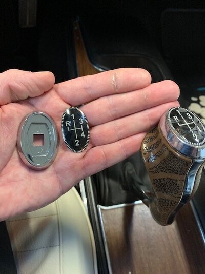

I was able to replace the grip as you can see, but I can't seem to figure out how the lens stays inserted into the bezel? The old grip's bezel looks like it was somehow pressed around the lens.
So, I left the old lens and bezel with the new grip until I can figure out how to secure the new lens into place on the new bezel. Thank you everyone!

Turns out the metal from the handle is peened over the bezel to secure it. I'm not picking that fight haha. Just gonna swap out the handles and leave the old bezel and lens on. It's a little cracked, but I'm gonna live with it.

Mine (I have two shifter handles) are not peened over, they are very tight though. I rebuilt my older one and used epoxy. It's not going anywhere.
