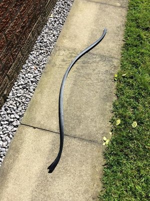

This piece of plastic trim was barely hanging on from the inside of the rear windshield.
It was kinda glued to the bottom above the center of the parcel shelf (Is that what you guys call it?)IMG_5969.jpg
It is semi rigid plastic and without force it wont bend to the contour of the rear window.
Is it meant to be glued or bonded or is there some other way to fix it?
Thanks

It just slips onto the package tray pushed to the rear and two clips screwed in behind the top of the rear seat holds it all in place

When I put a new package shelf in my car I had to pull staples out of that piece to remove it and we did staple it back on the new shelf.
Maybe the staples was an standard on the Green Runners.:yesnod::lol:

That sounds like a good idea. I will dig out the staple gun!
