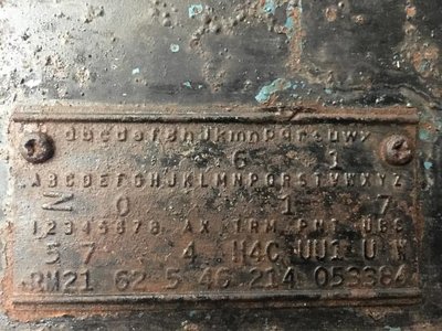

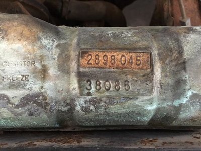

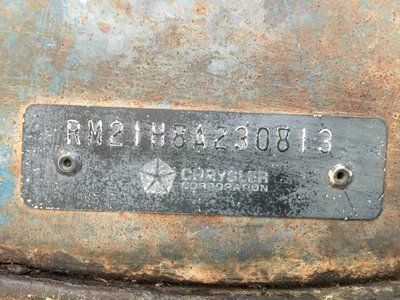

Yep. Here you go:
CAR: Plymouth Road Runner 2 Door Pillar Coupe
ENGINE: 383cid 4-bbl HP V8
TRANSMISSION: 3-Speed Automatic
TIRES: F70x14 White Side Wall, steel belted
BUILD DATE: February 14.
AXLE: 3.23 Rear Axle Ratio
INTERIOR: High Trim Grade, Vinyl Split Bench Seats. White on Blue Interior.
PAINT: Monotone Light Blue Metallic Paint.
OTHER: Light Blue Metallic Upper Door Frame Color. White Horizontal Accent Stripe.
MOLDINGS:
25: Drip Rail Mouldings
47: 'B' Pillar Mouldings (for coupe)
ABC OPTIONS:
F0: Decor Package
R1: AM Radio
Y7: White Vinyl Top
abc OPTIONS:
m6: Driver's Outside Remote Operated Mirror
u1: Sold Car When Built (Somebody Ordered It)
I used the decoder on the mymopar.com website for this one. '68 codes always blow my mind...
