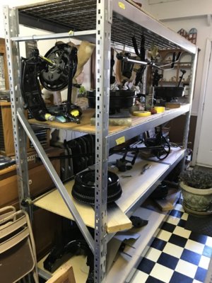

K Member parts primed and painted - Done! Also added new parts.

Yes sir you are moving rite a long. Good looking job. How much new stuff did you buy. What did you paint them with. Keep up the good work. :thumbsup2:

New ball joints, top and bottom, all new tie rod ends, a new idler arm, all new rubber bushings (I'm having trouble getting them in the sway bar), new races and bearings, had the hubs turned. It's gonna have all new rubber bumper stops. I used PPG single stage and I added a hardener to make it dry faster and a little thinner in the paint. I experimented with a gravity feed gun to keep the overspray down.

It looks like that you will have close to 5 hundred in the front end if you replace every thing. Not counting painting. Keep up the good work their Bob. Looking into ordering parts for mine first of the year. :thumbsup:
