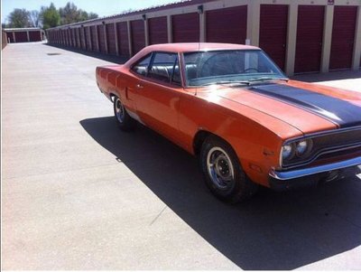

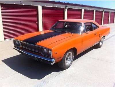

This is the way she looked when we first picked her up.

This latest Roadrunner was an eBay purchase. Although it still needs a lot of work, much of a restoration has already been done.

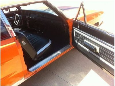

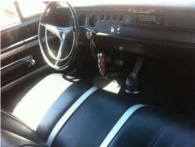

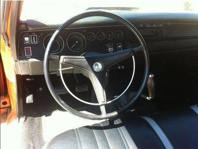

The interior is new from Year One.
Although it's sporting the factory AM/FM radio, it needs work. - Barely any radio reception and almost no volume. - A lot of static.

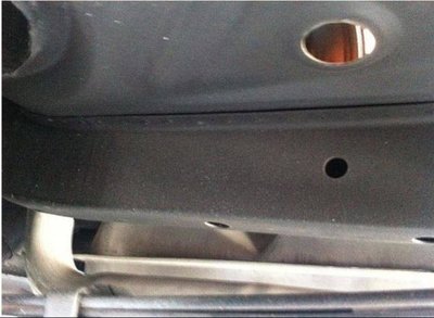

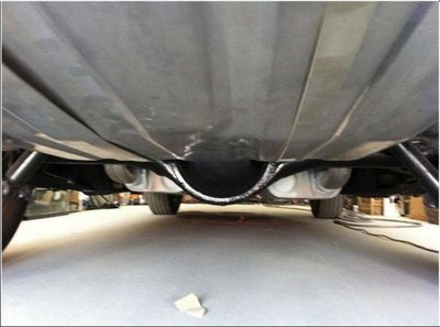

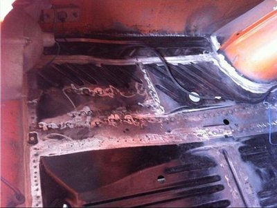

The bottom of the car is very clean. You can see here where the old floor welds had been drilled out.
The tic toc tach is not working. According to the fender tag, this car did not come with it originally.

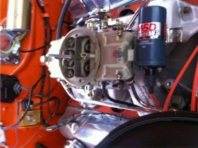

The 383 has been overhauled. It's running a 750 Holley and been converted to an electronic ignition.

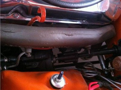

The power steering pump is tight and leak free but the steering box seeps.

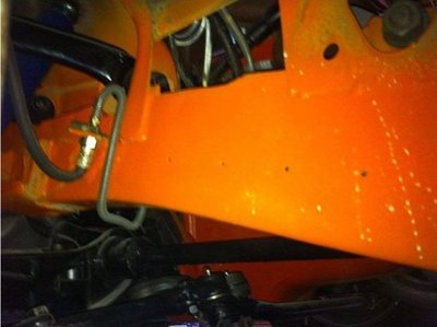

Another picture of one of the 'very clean' frame rails.
It's got a new fuel tank and the 8&3/4 posi has been freshly gone through.

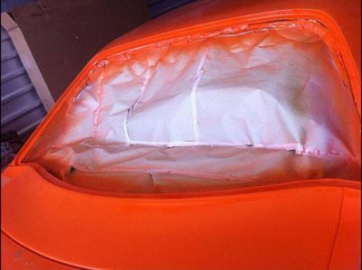

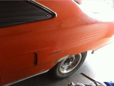

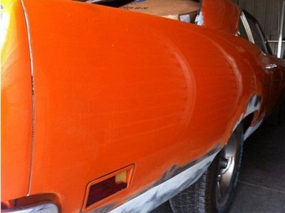

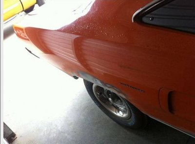

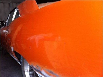

It has had some body repair to the lower quarters. Hopefully everything will look good when we get around to stripping it for paint.

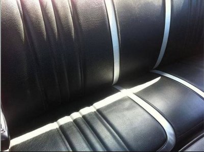

The new upholstery doesn't seem to have any flaws.

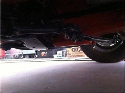

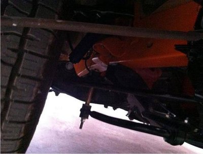

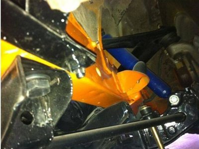

The front suspension is tight. Someone's already gone through it too.

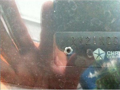

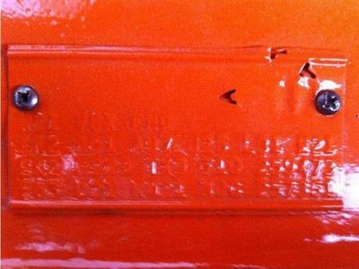

We did of course, check the serial numbers to make certain this wasn't a clone.
Although we're more accustomed to doing more of this work ourselves, it's nice to know that this front suspension is done.

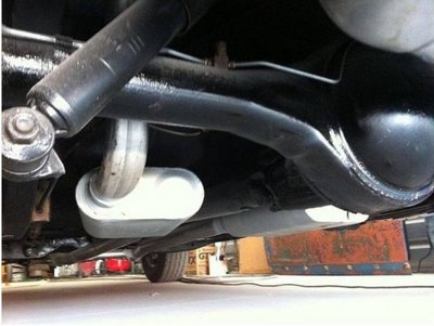

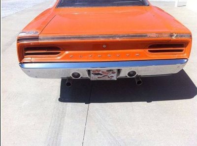

Although the exhaust is new, these mufflers are too loud for our liking. I love the sound of a big block but I'd like to be able to hear the stereo without straining.
Any of the pictures that we have that show body work in process were sent to us by the previous owner before we made the purchase. Other than a light skim where the quarter patches were done we didn't notice anything that gave us too much concern.

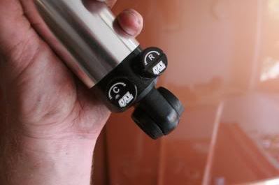

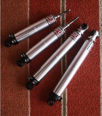

One of the things that we have changed since buying the car were the shocks.
We had a full new set of these double adjustable shocks sitting on the shelf. They had been bought for our '68 Charger project but my son decided to see how well they'd work on the Roadrunner.

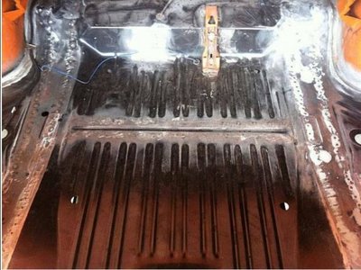

Another picture of the new trunk floor as it was being installed.
The previous owner had also replaced the panel beneath/behind the rear window. Apparently the window channel had been rotted out.

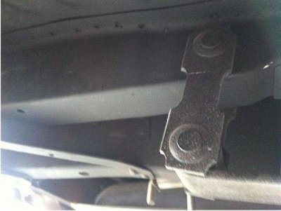

I was surprised at how much had been done. Even the rear leaf springs had new bushings.
The new shocks that were on the car will have to sit on the shelf for now.

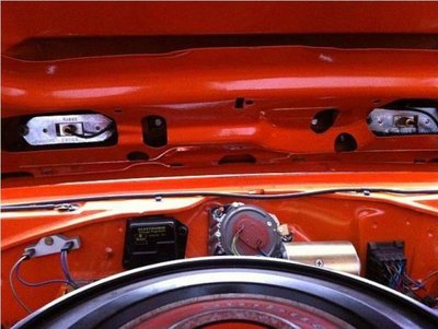

New blinker indicators in the hood. They didn't work when we got the car until we solved a grounding issue.

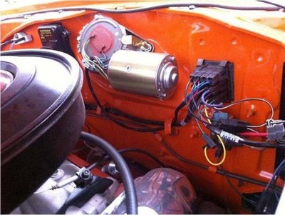

The wiper motor has been rebuilt and the wiring in the engine compartment was all new.
Looking down the left quarter.
Looking down the right quarter.

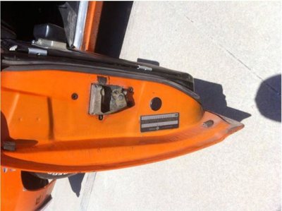

Unfortunately it's too hard to read the fender tag in this picture.

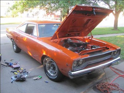

As good of a start we had when we bought the car, it did have it's issues. We picked it up from a storage facility that was gated and gave us limited area to drive it around. So although we weren't able to take it on a lengthy test drive we had a few hundred feet to run the car. When first started it was a bit cold blooded. I wasn't too concerned because I knew the Holley wasn't running a choke. I hadn't run a manual transmission in a long time and although I consider myself pretty adept with them, I couldn't tell for sure what was going on with the clutch. It definitely didn't seem to be adjusted correctly.
We were eager to get back home so after completing the transaction we loaded the Roadrunner on our trailer and headed back to Nebraska.

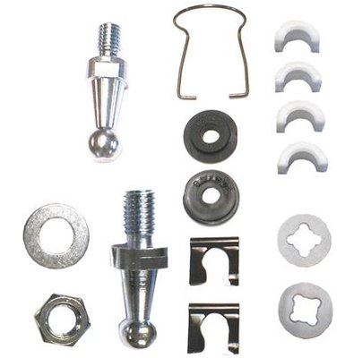

It was late before we got back home. - Too late to play with the car that night. Even though the car was capable of being driven as is, we knew that clutch still needed attention. The prior owner had said that he was aware that it wasn't quite right but assured us that everything was new and it was surely an adjustment issue. The next day was time for us to really try the car out. The 8&3/4 was running a set of 3.55s. Although we were aware of those issues with the clutch, we still hadn't tested the engine much.
We live in a small town of about 2500 people in a rural area. So there are open highways with limited traffic only minutes away. We drove to the nearest gas station first to make certain we wouldn't run out of fuel. I didn't want to assume that the 40-some year old gas gauge was accurate. After finding a secluded area we proceeded to run it through the gears. It was pretty disappointing. Although it didn't seem to run bad, it was sorely lacking power. After a few minutes we returned home.
I popped open the hood to see if there were any tell-tale signs of a problem. Although I couldn't see anything wrong, I almost burnt my arm on one of the hood hinges. The engine temperature gauge hadn't even reached 180' yet. Further inspection revealed that the heat was coming off the exhaust. - A possible sign that we were running awfully lean. Without having any replacement jets on hand we decided to investigate the motor further. When we put a timing light on it we noticed something strange. The initial timing was set at around 16' BTDC at 850 RPM. As RPM increased, the advance kept climbing until it was over 70' advanced and still climbing. We had only gone to around 3200 RPM. As far as how the car seemed to be running, - it was very sluggish on the bottom end. Unless you took it up to over 4000 RPM when you left from a standing start, you couldn't even bark the tires. Over 4 grand and it seemed to develop a decent amount of torque and HP. There were no signs of detonation as the timing advanced. So I was confused. Too much timing could have caused an increase in engine temperature, but it didn't run like there was too much timing. When we felt the firewall behind the engine, - it was still cool and the intake and block were actually cooler than the inner fenderwells of the car. The heat was definitely coming off the exhaust. Adjusting the initial timing back and forth didn't affect the exhaust temp.
When they rebuilt the engine they installed a COMP cam. We aren't sure which cam because the previous owner never supplied us with the info. When we asked him over the phone about the build, he told us that the block had been milled but he didn't know how much. He couldn't tell us much more.

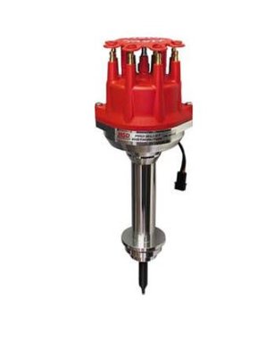

I began to wonder if the cam and crank were synchronized correctly. The prior owner had done the assembly and he didn't degree the camshaft. One other theory I had was that there wasn't enough valve lash after the block was milled. The engine was still running stock rocker arms and pushrods. So, I decided to test my theory by shimming the rocker shaft with some brass shim stock. The effect was that we seemed to lose some power and increased the valve train noise. I pulled the shims back out. I put a degree wheel on the front of the motor and used a piston stop to see if the 0' timing mark was accurate on the harmonic balancer. It seemed to be within 1'.
So I figured that I should focus on what I did find out from my tests. I was certain that we were getting way too much advance and indications were that we were probably running too lean. We have always been big proponents of MSD equipment, so we ordered an MSD Pro-billet distributor and an MSD Digital 6 Plus control box. Then I went ahead and ordered the full set of replacement Holley jets to experiment with.
When the parts arrived I began to play around with them. After doing multiple jet changes we ended up increasing the sizes by about 8. The exhaust temps normalized. The switch to the MSD equipment seemed to give us a substantial increase in power throughout the entire RPM range. Although not a super powerhouse, the car was beginning to behave respectfully.
We had a friend of mine test drive the car who was much more experienced with manual transmissions. He made some clutch adjustments which improved things but said that we should check our Z-bar bushings. When we did, we found that they were actually missing. He set us up with some extras he had on hand. Viola! The clutch problems were gone!

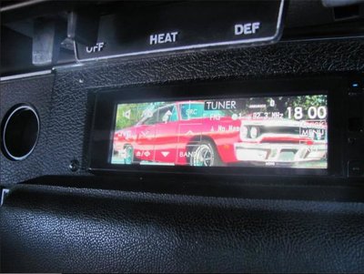

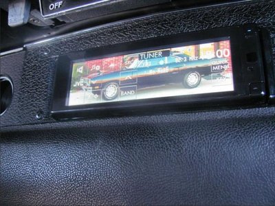

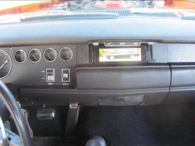

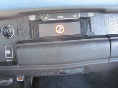

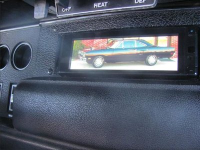

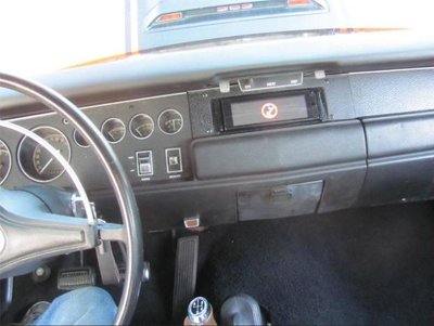

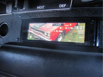

After getting the Roadrunner to behave respectfully on the road my son decided it was time to address the concerns with the radio. As sweet as the sound of a big block may be, sometimes a guy wants to hear some classic Rock and Roll while waiting in line at the Burger King drive thru. The static that the factory radio was putting out just wasn't cutting it. We knew enough not to toss the original tuner but it was slated for retirement on a shelf in the garage. We're not into building mobile boom boxes. We like hearing bass but not from the car that's 4 blocks away. Nowadays it's really hard to find a new stereo that isn't sporting micro sized buttons that are really hard to find while driving. There are a few retro radios made that are a lot more driver friendly and are a better fit in the old dashes. I was leaning towards one of those. But my son wanted something more. He felt that the Roadrunner deserved a system that more exemplified performance instead of one that was more akin to a wallflower at the prom. What he came up with was this. A JVC KD-AVX77.
What's so special about it? Well, for one thing it utilizes touch screen controls. That translates to having larger button surfaces that are easier to find while driving. It sounds good. - Very good. Without running any external amps it reproduces sound crisp and clear with great highs, lows, and mid-range. There are I-pod inputs. It can act as a DVD player if a person wanted to use it that way. (we weren't that concerned about that option) It could also be used as a monitor for a back-up camera system. (we didn't care about that option either) What we REALLY liked was that it could display wallpaper. - That's right. Wallpaper. Just as a person likes to display their own custom background images on their computer screens, now we could do it in the car.
The obvious choice for wallpaper in the Roadrunner was to put a picture of a Roadrunner on the background. The radio is only capable of storing 4 images at a time, but you can always swap them out later if you want.
There are settings that you can adjust that will make the buttons disappear until your hand gets close to the touch screen or you can have them visible at all times.

To prevent having to cut the original plastic radio bezel I bought a reproduction radio delete plate. - (Hard to believe they ask $100 for them.) While I had the dash apart I found an old insurance card that had fallen behind it and was sitting in the dash frame. According to information on the card, the owner was from the Boston area.
