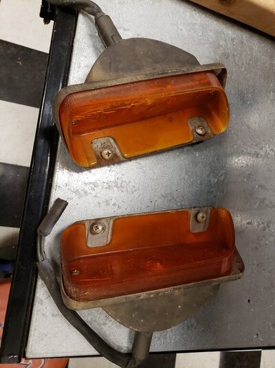

This is on a '70. Are you talking about the bumper that is mounted on the housing itself? See picture.

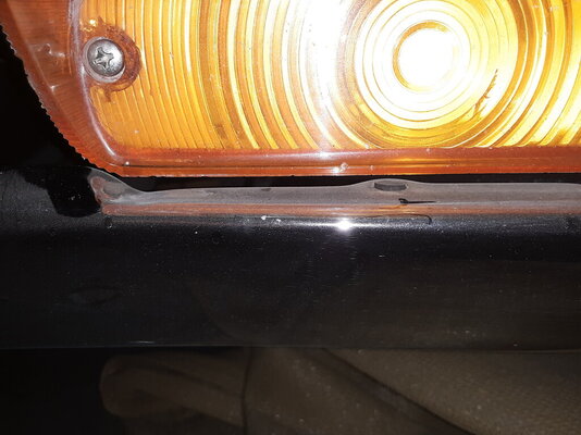

Yes there are bumpers on the bumper. Mine were flat and don't come any where close to the housing.
22,141
2,344

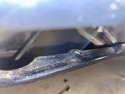

Little flat bumper that does nothing, but they were on the car when I took it apart. Dusty LOL

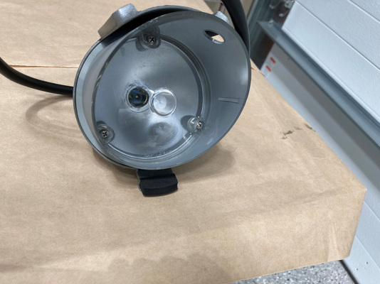

Those came in a rubber bumper kit when I restored my car, I might have a receipt for them.
