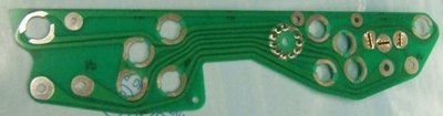

Do look at the diagram in this thread that shows the location of each lamp socket, it is helpful in locating them

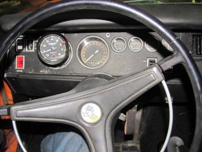

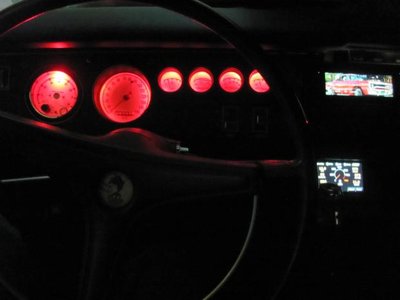

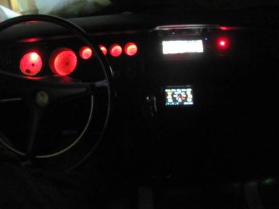

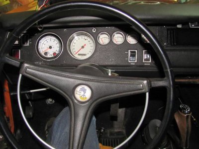

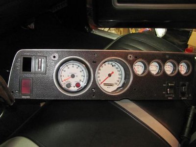

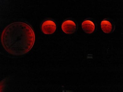

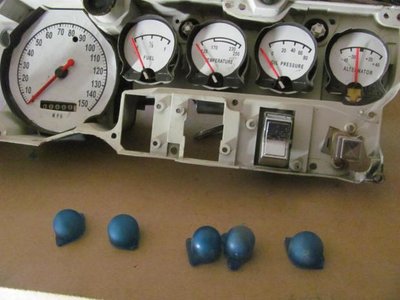

Since the time that I'd posted, my son had me work on the dash in his '70 Roadrunner. The gauges fried when the voltage regulator went bad so we swapped the black faced cluster with a white faced one we had for his '68 Charger.
He wanted to go with

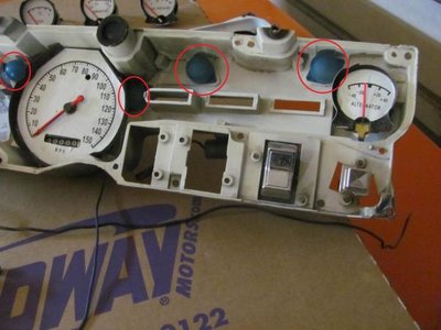

red tinted bulbs. My past experience told me that the various colored lights don't seem to illuminate nearly as well as the white. When I searched online I saw that there were very few sellers that listed the lumen ratings of the bulbs they sold. I ended up buying bulbs from superbrightleds.com even though they were the most expensive ones out there. Although I used to think that all of the L.E.D. bulbs were going to produce the same amount of light I saw that there actually was a big difference between some. They ranged between 5 lumen and 350 lumen. We chose bulbs that were around 100 lumen. Even they could have been brighter. They were still too dim until I removed the blue domes that they sit in. The camera makes them appear as though there's glare, but there isn't.
