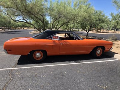

6D4F9DF7-DE2D-42F6-A238-98C703806103.jpeg Hey all,
anybody use these Mancini lowering blocks? Before I buy my new tires and get 27 inch rear and 26 front
Currently 28 rear and 27 front.
I’d like to maybe lower it an inch or two in the rear with blocks and then I could lower the front with torsion bar.
fairly easy I think he did it years ago on another leafspring car they give you new U bolts and it brings the rear up an inch or two whatever block you buy fairly easy job. I don’t want to change my leaf springs I like the way they ride pretty much .
