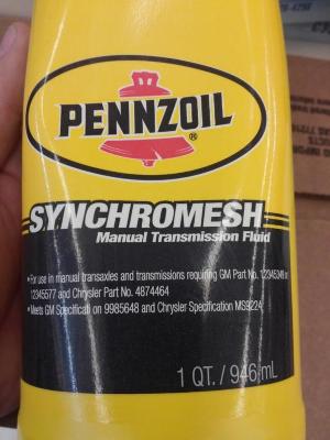

That said, the '69 service manual calls for SAE 140. I tried that and it shifted like it was filled with molasses (in January). Gear clash in all gears until it was warmed up. Drained it and used Sta-Lube 85/90 from Napa. Better but, still had some 1 - 2 gear clash when cold. I was advised by a Mopar expert to try Pensoil synchromesh. Worked like a charm. I'm a believer.
