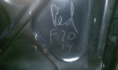

Under my deck lid is marked RED F70 14 I'm guessing it has something to do with the tires and toms

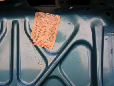

Looks like a red line tire, is it actually spelled out like that and do you have the broadcast sheet? Maybe a pic :popcorn: Mine shows 70X but the wheels were blue, the X makes me wonder if the guy was just checking off that the tire was put in and the proper 70 series tire as in an inspection mark. X usually means black, Mike A12 had some discussion going over on the "LOH" lift off hood site trying to nail this down.

I haven't found a broadcast sheet yet Alex is gonna post the pic of the markings

Im not sure I wonder if red is for redline tires F70 for firestone 70 tires and 14 for rim size

Lynch road, I was talking to a knowledgeable mopar guy this morning he believes its refering to the spare only
724
.......'68 came standard with F70-14 tires with either white or red stripes. The grease pencil marking inside the PP-1 Matador Red trunk lid was scribbled by the Lynch Road line workers as a trigger to make sure the car was equipped with an F70-14 Red Streak spare tire. This way it'd match the rest of the tires. With the optional chrome Magnum 500 wheels, this red Runner was a stunner.
.......In the trunk of this '69, we spotted hand-scrawled grease pencil markings similar to the red '68 in this roundup. But this car's mark reads 70W, indicating it was originally built with white line tires-a no-charge alternative to the Red Streaks.

yeah......see it was printed RED and not written......so maybe somebody did that
Yeah - a line worker just like it says in Harold's post right above yours. This is extremely common. Can't believe you guys haven't seen this before. No different than grease pencil markings on a valve cover or a "Paint OK" stamp on the fender or core support. Just standard assembly line markings.

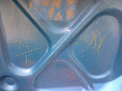

Here's a pic of the underside of Bambi's trunk lid showing the markings for the spare. G70 15 Red Line. No idea what the SKX/SHY/SHX/SKY (or whatever the hell it is) markings are for...It's been seen on other A12's also but no one seems to know what it was for...

Might just be the inspectors initials :manhole:
