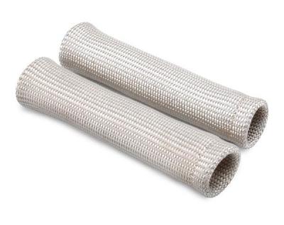

I just melted my 3rd cable earlier today :facepalm:
Drove across town and the shifter felt kinda mushy.
Next thing I knew, it was stuck in 3rd and that's how I drove all the way back to the shop in traffic.
I had it sleeved with one of these....
And also had it covered with these wherever it was closest to the header pipes....
What's odd is that it melted at the loop, which is nowhere near the pipes :eek:
The part that's actually touching one of the pipes looks fine.
Oh well, gotta pick up another one in the morning.
Maybe I should pick up two and keep it as a spare
