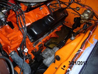

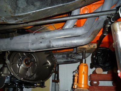

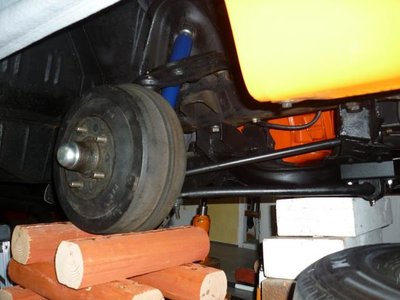

Once again, THANK YOU all. We are very fortunate to be able to get on a website like this, with like minded individuals, and helpP1090715.jpgP1090716.jpgP1090722.jpg each other out.
I will be posting pictures once I complete the task. Here are a few............
