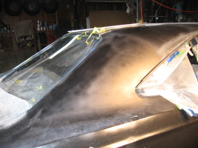

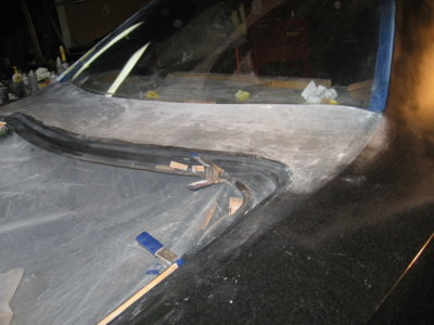

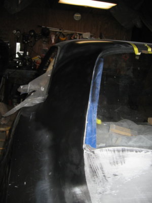

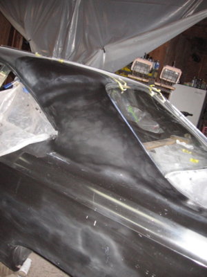

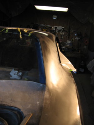

Well here is the progress I have made since the last pic's. Just about got it still need to fine tune the Dutch mans panel. Well what do you guy's think have I got it or not. Painted it black so it show's up every thing then sand some more. IMG_0101 (1).JPG IMG_0102 (1).JPG IMG_0103 (1).JPG IMG_0104.JPG IMG_0105.JPG

Well from the looks of the pictures the sides and the top and bottom look a little tight but a little loose in the bottom corner mine is about a quarter inch all the way around
7,704
Brett if you are talking about the glass gap. I have about a quarter inch or so on sides and little more on the bottom and top of glass fit. Had to cut down spacer blocks at bottom of window to a little over a quarter inch. Sorry for the blue tape it hides the edge of the glass. The tape was to keep filler from building up in their. I will keep at it. Just was wondering if the sail panel area looked ok. As soon as the trunk filler panel is tuned a little more will call it good. Getting rid of the line between the filler panel and the quarter just going to make it smooth. Seen some like this they got rid of that joint or line. Thank you for the input.
