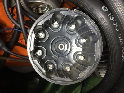

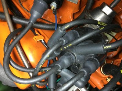

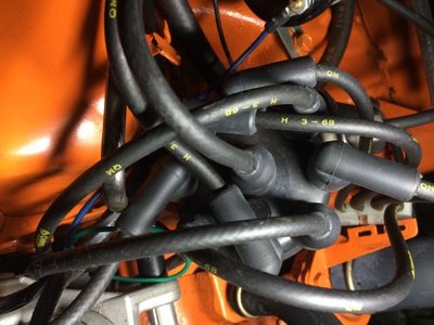

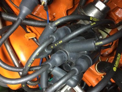

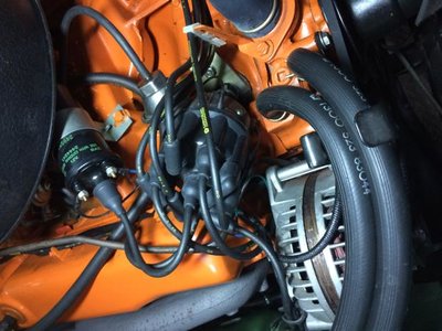

Ok seems like the Ignitor III is not what I need.
I need to know the part number of the Dizzy so I can order the correct Ignitor II kit.
Its a single points dizzy. See photos
Do any of you guys know which one it is or do I need to look for something else. There is no tag on the dizzy with a code number on it. Just a "70" stamped on the body.IMG_6005.jpgIMG_6006.jpgIMG_6007.jpgIMG_6009.jpgIMG_6008.jpgIMG_6010.jpg

Great. Sounds like just what I need. Can I use the stock coil?
What about the Ignitor III - any better?
I use the stock coil in my car, no problems. The Pertronix II part # is 91381A for the single point distributor. I'm not familiar with the III version

The only thing that i can think of is that it is a bad unit or they have sent the wrong part number.
It is definitely the stock Chrysler distributor so should be part number 91381A.
I will post up a picture of the Pertronix ignitor module and the position as mounted in the dizzy.
I even elongated the adjusting slot so as to give it more adjustment range but it didn't seem to make a difference.
