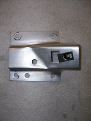

I'm missing the muffler hanger on the drivers side. I ordered one and its a bolt on piece, and the passenger side is welded on. The drivers side does have the holes for a bolt on so I'm guessing thats they way they came? Is this correct? I have some pics for reference.

yep that bolts on the 4 studs and the correct hanger and clamp bolt to the clip in the bracket.:thumbsup:

The right side was welded on as all single exhaust cars had to have it. The left was bolt on for dual exhaust cars.:cents:

Thanks for the info. I was thinking that was the reason, but it was a little wierd that the hanger was gone. But I guess nothing is too weird on these cars after 40yrs. And I did not see any signs of coat hangers being used.
