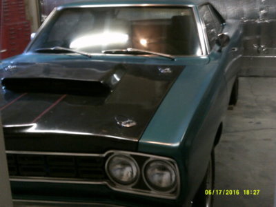

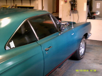

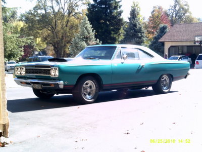

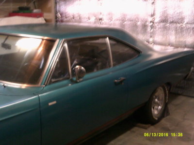

I'm thinking the last coat of clear was afternoon
it was warm, probably 80* to maybe 85* in the garage
I used the same gun/air/nozzle settings I did on the 1st 2 coats
I think I may have been moving too fast,
maybe I was impatient, after smelling paint fumes for a day or something
maybe kind of a dry coat, on the final coat
it cleaned up pretty well
I'll have to take some more photos, with a better camera
than the cheap ass $49.99 Vivitar X022 (Walmart) digital
I have a flip phone, no camera & I'm a lousy photographer
it's a labor of love
never mind the date stamps they are wrong, too
it was just a while ago I took the ones in the garage
