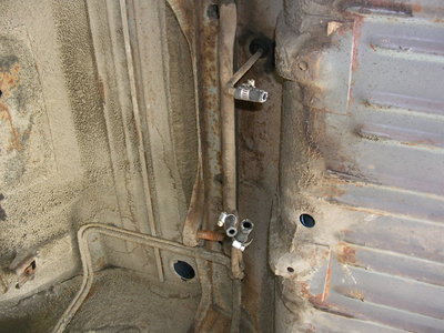

Can't remember where the j bolts hooked up, was it on the pan or the shock brace running across the pan, laid under there and can't find the slots after putting in the new pan, anybody got a pic

J bolt bracket.jpg Looking at some old post beware I don't believe my trunk pan had the brackets welded on for the fuel tank straps, I laid under there two hours today trying to figure out the issue, the brackets are missing for the j bolts, I found a 2012 post what a bitch..with only one welded in.......I never realized they don't come on the AMD pan...

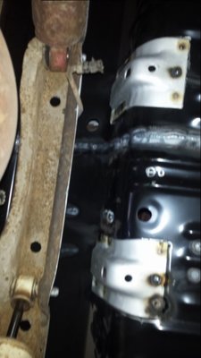

Look at the tail panel where the strap goes in and go forward from there and when they feel happy with the pan thats where they go. None of the pans come with them.roadrunner restoration 348.jpg
7,704
Yep did not think of that. What happened to the old pan. Cut them off and use them. That is what I was going to do if they are in good enough shape. My E brake bracket came with the floor pan and seat brackets'. You would think they would throw in the J bolt brackets for the trunk pan. Russ.
