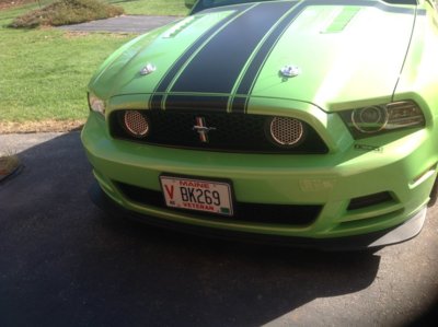

And this: Ford was too dam cheap and this came with prop rod. Put SS Redline struts in- work like a shock absorber. Hood has double latch and hood pins are faux. But the hood vents real lmao.B4D69487-8E3F-42E3-88C8-7C313DF3E04D.jpeg My apologies if photo before posted.

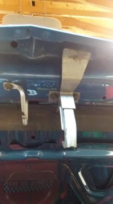

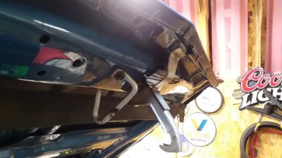

Hey Russ: Not sure why you have to drill new holes . My hood came from AMD and every thing bolted right up here a couple of Pic.75402244_2481338325265260_3278191916759384064_n.jpg 75603433_2481340465265046_2760917334213263360_n.jpg
