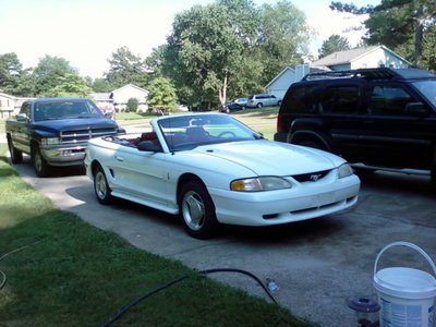

This is what I pick up from a work buddy
He was send it to the local scrap yard, I pick it up for 100.00
Needs new motor 1994 Conv.

Good deal, look like about a 95? I bet Stuie could fix you up with a motor if hes still on our island :lol:

Ummm...original post says 1994 conv. Old Timers Syndrome taking over? :acme: :jester:

:lol: :lol: :lol: I was looking at the truck, I didn't read that part with the top down I thought it was a running car. I guess Ill just go have myself committed :lol: :lol: :lol:

Nice score for $100, Tom.
