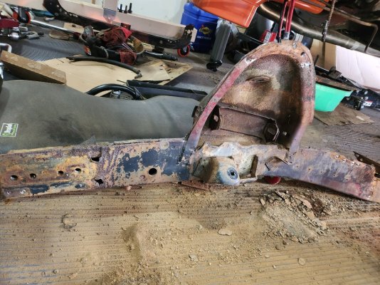

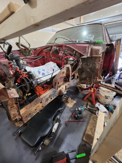

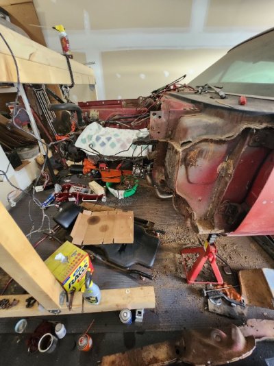

Picked up a 69 a few months ago and have not had much time to get started on it. Still getting my shop put together and get thing put away from my move and shop build. Not much progress, been busy getting moved into the new shop and getting things Slowly organized. Started tearing down the interior and looking things over and just as expected there is more rot than expected, still not bad so far. Ill try to get some more pictures of the problem areas. Looks like the ole girl was hit in the front LH side at some point in its life. The frame rail has some heave metal patches welded to it, I bought a new frame rail and going to have it installed......I feel like that is way over my head. Im in Weatherford TX and called Tripple F but not sure when they will be able to get it in. If anybody knows some other places in the Ft Worth area im all ears.View attachment 39800View attachment 39801View attachment 39802View attachment 39803View attachment 39804IMG_5295.jpegIMG_5296.jpegIMG_5297.jpegIMG_5298.jpeg

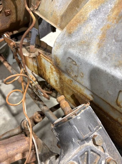

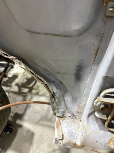

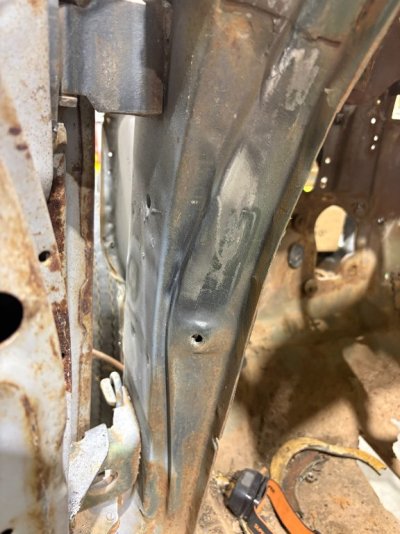

Up at the shop today and took some more pics of the problem areas so far. This is on drivers side, looks like it got dented in when it was
hit at some point.

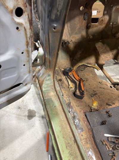

This seem to be a repair because the original color is LimeLite green and this part is blue along with the fender and door.

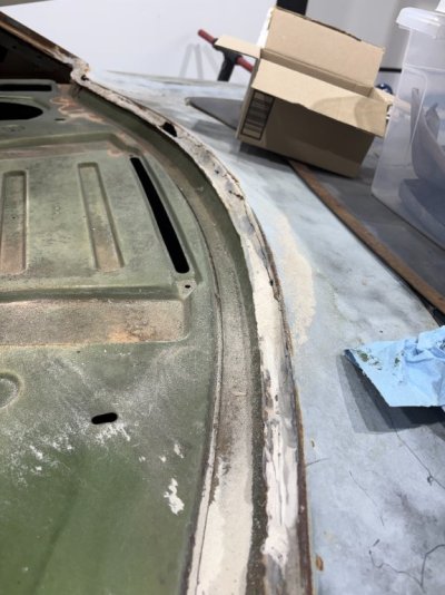

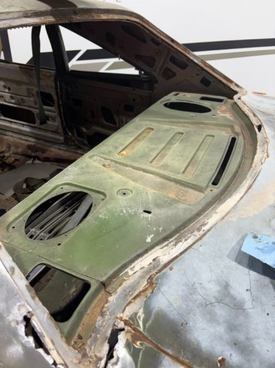

Package trey look good but the dutchman panel is shot....new one on order!

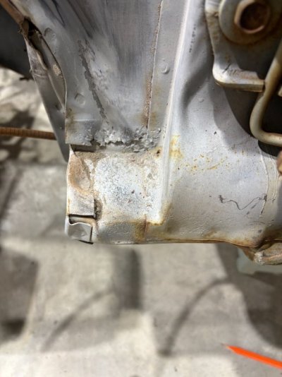

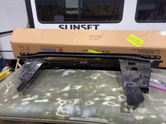

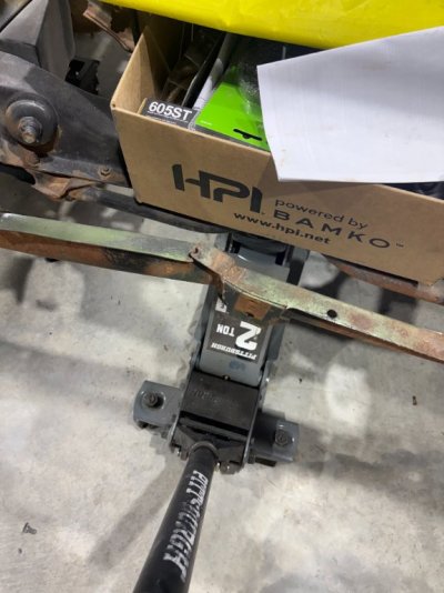

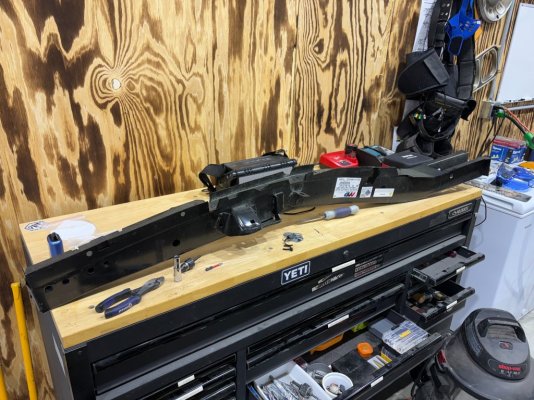

More signs of a hit, I have a new radiator support and bottom suport.
New parts waiting to go in. Going to have a shop put the car on a rack to make sure everything is straight and have them weld in the new
frame rail and radiator support before I do anything to the car.
Here you can see the steel plates that have been welded to the frame rail.
Welcome to FRRO. Nice project you got there. Don't sell yourself short. You can replace that front rail yourself! My 69 is my first build too. My LH front rail and inner fender under where the battery sits were rotted out. I decided to do it myself (couldn't afford to pay someone else to do it. ) I'm glad I did. I learned a lot during the process and it turned out really well. Great experience and it gave me confidence to tackle the rest of my project. Give it a shot, just remember to take a lot of measurements, I forgot to do that. You can always pay someone else if it goes south on you. Good luck on your build and keep us updated.
Very nice. That gives me some hope. I’ll let you know. Thanks for the encouragement.
Just take your time and lots of pic's. Measure-measure and measure some more. That replacement is not that big of a deal had to do one of mine also.
Only issue is it was hit so might be out of whack, putting it on a frame rack to check the measurements before replacing the rail would probably be a good idea.

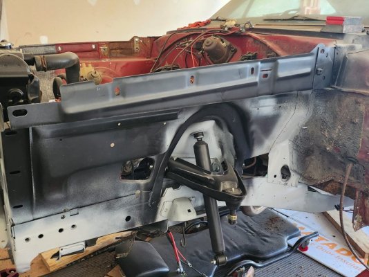

Once done with sheet metal coated the under neath with bed liner spray on. In frame rails inside with anything that might could be painted with it. Yes, it had some sand in it but that did not bother me too much due to having to thin it down to go through my spray gun. The mud they put on bottom was cleaned off then painted it with this. If it did not get color it got bed lined. LOL. Good luck and wish you the best with the project. Products from east wood was the place to go to.
Some of the parts put on the car. Tried to take a lot of pictures but got busy just trying to get the thing done. Blanked off the fresh air duct on lower cowl. Have aftermarket auto air in the car.
