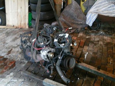

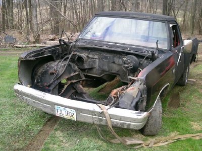

so the 5 speed in the truck has been making some nosies for a while. Didn't really know how intense these noises were until the weather got warm enough to drive around with the windows down. Definatly on borrowed time. So, I've still got the black truck my Uncle gave me. body is totally shot,kept it around for spares and the warmed over 318. Been wanting to put the 318 in the red truck anyway, so with this being my one weekend off a month I figured I'd dive into thing. Figured with fours days I could get both engines out, and the 318/girlymatic in the red truck and be good to go. Well that didn't get as far as planned. Finished up my 7 daylights Thursday, so I was really wanting to sleep in Friday. Then I had to take The Boss to her eye doc at 1, so no sense starting anything. Then we went grocery shopping. didn't get in the garage till after 5. By 9 I had the engine/trans ready to pull(more or less). Got back out before noon Staurday, and got them out. Now I need to get the V6 and 5 speed out of the other truck. After getting up and down for two days, I've got achey muscles, and as much ambition as Paw Kettle. I'm on midnights this week so it looks like I'll be driving the Intrepid to work since It'll be nice enough for The Boss to have her VW out.

so this little diverson put me behind, but I did get the V6 & 5 speed out of my red truck. Then back to work. Hope to get back at the truck my next days off.

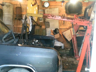

well Joe, that sure didn't happen. Got the 318/trans in the truck Saturday. by that I mean just sitting in the truck. couldn't get the motor mounts to line up, then I had to get cleaned up and head to work. then it rained the next couple of days so I didn't mess with it. was off yesterday and today, so I figured I'd get a lot done. turns out I just shoulda went downstairs and played withthe trains. Couldn't get the mounts to line up, so I started measuring. shoulda done that first. Seems that Chrysler, in their sense of humor, put the motor mounts on the crossmember of the V6 trucjs about 4" farther back than the V8 trucks. :facepalm: :brickwall: :brickwall: :brickwall: :soap: so My Uncle's gonna be doing some fab work.
well my uncle stopped by yesterday. things aren't as bad as I first thought. The passenger side motor mount lined up. (amazing what fresh eyes can do) Unc's gonna fab up a new bracket for the driver's side. I checked the trans mount, and it needs a piece added, stuck the driveshaft in, and all's good there. I think it all boils down to the 21 turn, not feeling like messing with this stuff because of the different turns. Did get the steering columns changed, swapped out the dash wiring(saw a few different plug ends between the years) and the intrument cluster.
