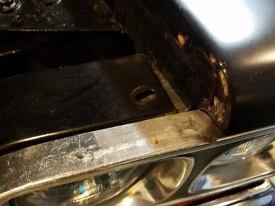

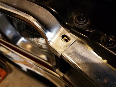

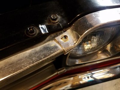

Okay, so I'm new to this rebuilding hobby. As some of you may already know, I just purchased this car just in time to store it for the winter. It's in decent shape, but I'd like to take it apart and rebuild in the future (some rust issues that need to be addressed) so I've been doing a lot of reading until then. In the mean time, I'm starting to see little pieces and parts missing. I was looking at the engine bay last night and noticed some bolts missing. I'm curious, where do most of you go to get these factory parts that are specific to the car? Is there a well known fair priced distributor in the US that has parts for these cars that you can recommend to me? Right now it's just nuts, bolts, screws, etc., but I'm gonna need a place to go for other stuff next year. Attached are 3 pics of bolts missing. 2 are for the head lights and the other....not sure.
Any help on this would be much appreciated.

The headlight bezel to grill screw is a #8-32 x .40"large washer head phillips drive self threading screw chrome.

Upper support bolt is 5/16-18 x .875" lg. hex head SEMS bolt phosphate finish prior to paint grade 5.
