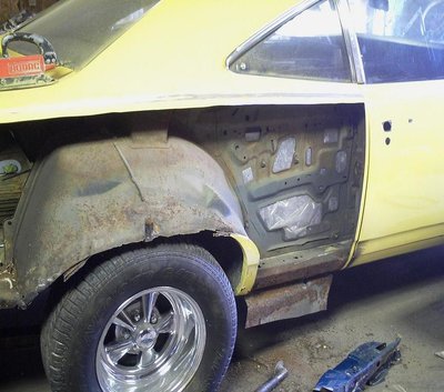

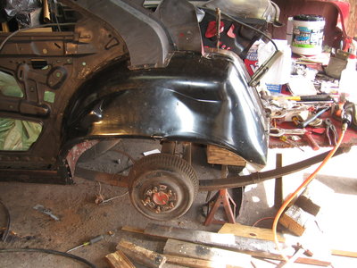

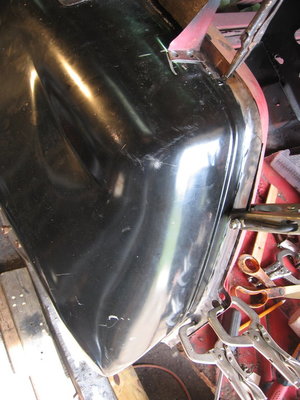

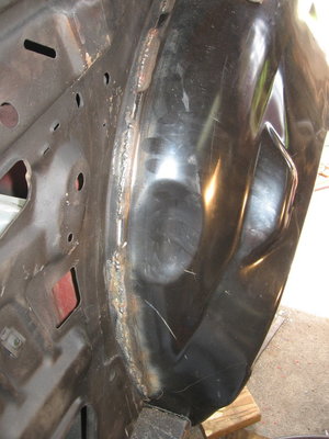

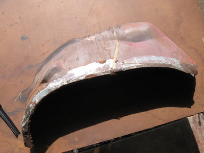

Here is what I did to put in the Outer wheel housing on driver side. Cut part of the old off but left enough to weld the new one on in the front in the back did not cut it off so welded to the old Inner tub. Had to weld some on the inside to finish the welding process. I hate welding up side down. Russ. IMG_0101.JPG IMG_0102.JPG IMG_0103.JPG IMG_0104.JPG
nice job Russ. when my guy cut my pop riveted bondo laiden 1/4s off, we were really surprised how nice my wheel housings were.
