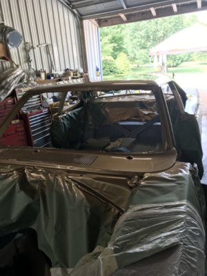

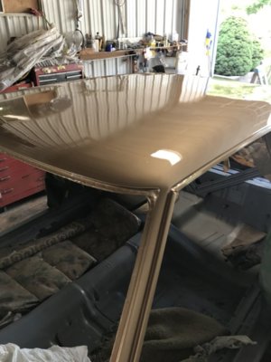

Thank you Russ! it was a good arm killer and i could not see what i was doing out there in the middle of the top, but it turned out pretty good. just takes a lot of practice and moans and groans and sore arms and legs and knees!!!

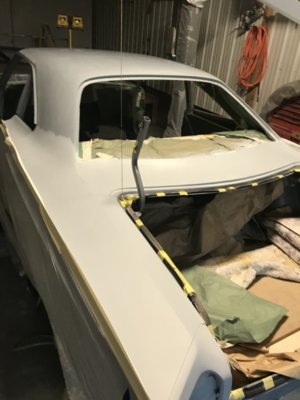

I hope to get my friend over this weekend and start on the top and work on the back glass too! it will probably take a while to get this top on. he does a pretty good job.his looks nice!

Looks like you did a perfect job with it. Worth the effort!
