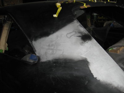

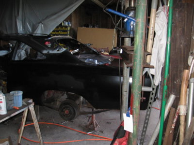

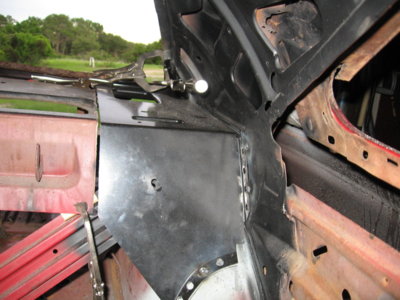

When doing my car did the package tray first. Fixed all rusted out pieces. May need the corner filler's also. Depends on how bad every thing is. Then put the quarter on. The roof lay's over the quarter and their is a lead joint their. Will have to drill out the weld's. May have to bend that area on the roof out to get the quarter to slide under it. Their are corner filler's for the rear window frame. Thought I took more pic's but here are a few that might help ya. I use all metal to fill that joint. tried to figure out how to get it straight. Used this trick filled the area with product the used a piece of 3/8 inch plastic fuel line and drug it from the window opening to the rear window. It worked perfect. IMG_0105.JPG IMG_0103.JPG IMG_0102.JPG

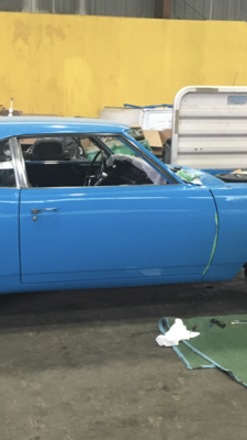

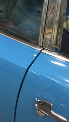

I used AMD panels and they are pretty good. One thing I found out too late to fix was the rear quarters radius was a little different then the OEM doors. If you look up from the rear of the car you can see that the door sticks out slightly farther than the quarter. I didn't have the doors on or that could have maybe been fixed. Big Mo.
7,705
Have you tried to move the striker in. I am setting my door's now they are AMD. With AMD quarters. Something with the line of the door not matching the quarte. Even if you have the top of the door flush from top of quarter and door. Well it is what it is and not going to be able to do any thing about it. But it all looks better than a rusted out piece of junk. LOL.

Hey Russ don't know if you tried or not but the door can be tweaked in and out by loosening hinges on the door side of the hinge, I had to tweak mine to match up to the new AMD quarters on my 68 it seems like very little but it did help.

I have run out of adjustment on the hinges. The door fit's fine but the bottom of one door is curved at the bottom. Start fine a the front rocker the curves out and some gap at the back near the rear quarter. The drive side I am happy with. Fit fine but the body line's are off. You all know that you assemble the car before welding and every thing look's fine but one you are trying to finish the car things just don't line up like they should. So you have to make things work. Had to take some metal out of one hinge hole so it would slide forward to get the gap at the rear quarter rite. This is my last restore job any way's but want it to look good. Russ.

Russ, The top and bottom of my door and quarter line up very well, it is in the middle where my problem is. The gap is pretty good also.
7,705
It is not that noticeable. But I know it and that drive's me crazy. Have worked so hard to make the car perfect. Expected more out of the parts I ordered. I will live with it. No need to call the people that make it or the supply people they tell me your just luck to be able to get the parts. Or some thing that is close to the old one. Moving forward and going to finish the car. Hope it dose not give me a problem.
