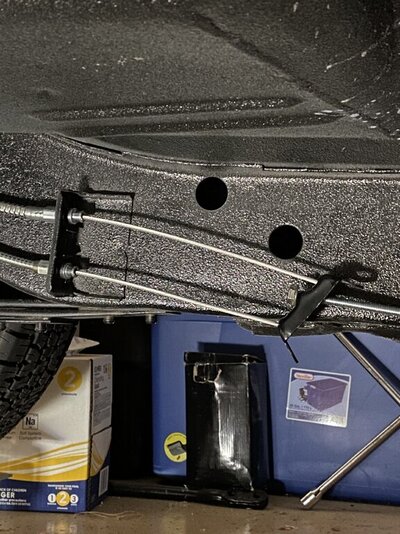

If I didn’t have to “fix and or work reproduction parts I’d be way more done. On the park brake, the.short cable from driver side rear brake, cable is 1” too short. Asked in line tubing (where I bought the set) to sell me just that one. Let’s see how that goes.

Did not have a problem with the inline tube E brake cable. That has to be frustrating it is too short on one side. Wish you luck with getting that problem fixed.

Is everything equal in the backing plates?
Yeah, pulled both drums yesterday to be sure. Nothing found, everything as it should be.
In line gave me the dimensions that the cable should be so I’ll pull the cable and measure. They did offer to sell me a custom length cable for $100.00.

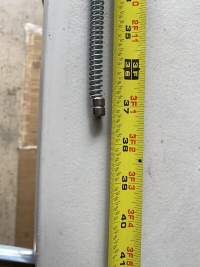

I removed the cable. In line said it should be 37 3/4 cable length. Too short by 3/4 inch. Exactly what was needed to have the proper fit. Waiting for them to respond

The one I have is the same length as yours
That is strange. Is that why it is extra? In Line gave me the 37 3/4” length for the cable itself and 23” for the outer. The outer measures 24 overall and 22 between the mounting stops?
And if I had another 3/4 it would fit fine as needed. No response from them. If I don’t hear back in the AM I’ll order another. That one piece I can get for 40.00 from them.
The in line support mail sent me this:
That brake cable should have a measurement of 37-3/4 inch inner cable and 23 inch outer housing.
