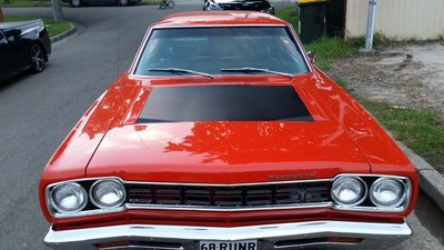

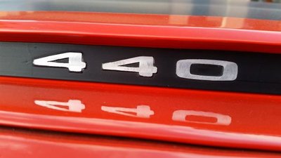

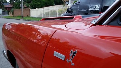

Got the performance hood treatment on my 68 RR, complete with non-functional sideways hoodscoops - basically just cool-looking scoops that provide a place for the engine callout to reside.
20170301_191944.jpg .
20170301_185302.jpg .
Anybody here ever converted them to functional ie internally cutout? Is this even possible, or would I have to change the bonnet altogether?
If it was possible, is there any evidence to suggest any improvement in sucking up that fresh air?

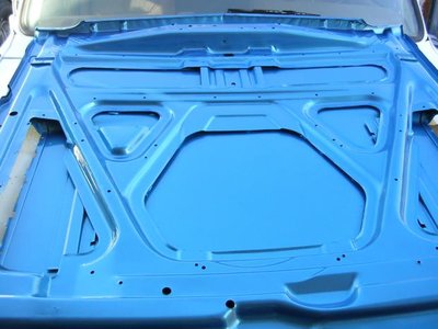

I'm not 100% sure but I think the 1969 air grabber and call outs with screens will fit but some bracing under the hood has to be cut out.
you're correct Bobby (and I'll deny ever saying that)

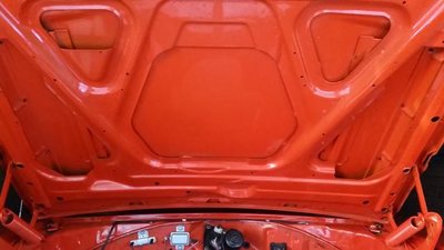

Here is a picture of my hood without th air grabber in place to see the bracing

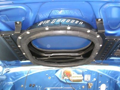

In theory yes, cool air is more dense than warm (hot) air.
In reality, setting the placebo effect aside, you might need a dyno to really tell.
I had the Air Grabber on my first '69, but don't on this one. I had briefly considered adding it, but after pricing it out, I decided that the cost was not worth the gain (unless you are racing it).
cheers for the pic. mine is looking like this at the moment
behind the callout (external) theres a black plate with 4 screws, but from inside it feels as though theres about a 2-inch gap to the inner wall of the scoop (what would be the back of its throat). could this be cutout (even just to allow airflow) or would it need to be changed over altogether?

from the looks of it you can just pull out the whole asy and replace with air grabber asy no cutting. I cant see a car company making that be of change between two hoods just for call out emblems. Steve
the air grabber didn't come out until 1969. the OP's car is a 68. when you pull the call outs off the '68 hood, there is metal there that wasn't there on the '69 hoods. you can put '69 callouts or vents on a '68 hood...I've done it, but there is metal that needs removed. and car companies do things all the time that don't make sense. Dad had a '66 Ambassador that you had to cut a hole in the floorboard to remove the starter bolts, a '76 Bonneville that required removal of the right inner fender to replace the blower motor. and ever change the master cylinder on a non power brake B Body...it will increase your vocab!
Yep, saw the 69 call outs on a 68 hood with a few mods. I don't know if it works in reverse though.
Either way, the air grabber is pretty heavy and there's no performance gain anyway. You have to have the right air cleaner etc.
I would suggest buying a repop A12 hood and then you have as much scoop as you can stand.
I had a feeling that there might be some problems with alignment etc because of this reason. I think it sounds like more trouble than its worth/
