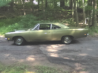

If you look at the door window area of my car you'll see a chrome strip that covers the post between the door window and the rear window. The rear window does not roll down, but instead is hinged on the post and just swings out at the rear of the glass just a few inches These cars are also known as "post" cars. On the hardtop cars, you can roll down both the door window, and the rear window and have an no obstruction from the vent window back to the front of the "c" post You can also tell from the first part of the vin number which one you have. With my car the vin starts with RM21, for a post car, The RM23 vins are for hardtop.

Not all of them got the stainless trim - some (like my A12) are body colored here. Just FYI.
There is one other aspect to this which many people overlook; the post cars are Belvedere-based and the hardtops are Satellite-based. Belvedere's were low priced cars and Satellites were high priced cars and the RRs fell neatly in between (at least at their inception - later variants such as the Superbird blew this out of the water...) - hence the "RM" as in "Medium Priced" model designator. If you never picked up on this before then think about this: When is the last time you saw a '68 Satellite post or a '68 Belvedere hardtop...???
