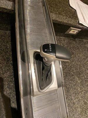

I'm looking to find out if anyone knows of a conversion kit or hurst shifter that I could put onto my automatic transmission. I know hurst has certain ones for specific models of cars but I'd still have to modify the actual shifter stick/lever

Something like this would be amazing. But I wonder what they changed for this to work

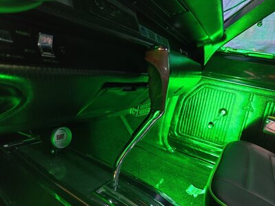

If you can bolt in a slap stick shifter from an E body, then you can use one of those pistol grip shifters. I am thinking about doing that myself. I don't have a console and mine is not original, so I don't mind it not it not being a "b body" shifter. I like the slapstick better than an aftermarket shifter anyway.

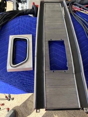

You probably can modify an aftermarket top plate (saving your original) to fit as well. This guy had a new plate made to fit the 8 speed shifter in it and it looks great.

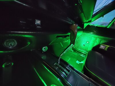

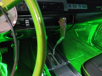

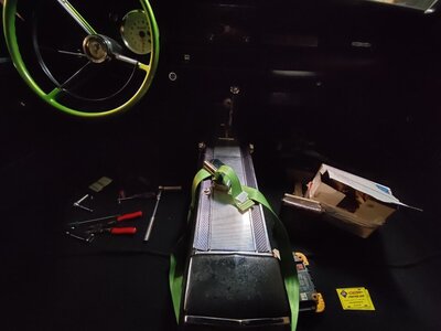

I ended up going with this route specifically because I wanted to modify as little as possible. Pretty expensive but I'm hoping the end product turns out amazing. I'll post pics here after I'm done with it
http://www.restorick.com/proddetail.php?prod=AutoPistolGrip
oneyedmonkey
Mar 31, 2021
16

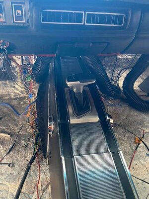

Just wanted to post an update on the product and on just how well it turned out. I will need to do some adjusting to make it a bit tighter. But that's only because my original shifter arm is worn down. Everything is beautiful and well made. Not to mention one of the simplest upgrades you could make.
