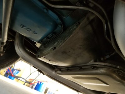

Take a look at this picture. What looks to be leaking to yall?
7,705
Thing is what dose it look like trans oil or motor oil. In this area could be transmission seal or rear motor seal. Could be coming from the torque converter. Rear motor seal is a two part seal and where prone to leak. Take a sample of it to a local mechanic. The smell test should tell you if it is trans fluid or oil. :praying:
7,705
Yep Quick bird. From what I see it is pretty thick so tend to think it is motor oil. Hate to replace the rear main seal it is a pain. If you have to do the rear might as well do the front one also while you are their. With the pic. he cut off the floor where it would be puddled.
