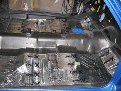

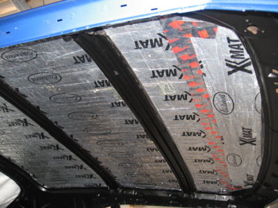

Got the X Matt from East Wood. Installed the roof insulation and hood insulation. Also doing the floor with the heat and sound reducer insulation but wondering how much to put down. Like the tunnel should I rap it also. Want to put some on the back seat pan. Thinking just the bottom part of the pan. So any suggestion would be help full. Russ. :thumbsup2:IMG_0102 (2).JPG IMG_0103 (2).JPG

Just to add I got the box for the floor for around 100 dollar's the roof cost was 75 dollar's. Did not figure that was a bad deal. The ting is it will all get covered up and will never be seen. Just was worried putting it on the tunnel might interfere with the console in some way. Any thought's would be appreciated. Russ.

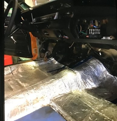

Thanks for the pic's HD538. It will be a little more work I have the console. It was a floor shift car so I decided to go with bucket seat's and the console. How do you like it with the sound and heat reducer insulation. You did a good job on it. Russ. :thumbsup2:

It really helped. Replacing the floor insulation and the firewall insulation made a noticeable difference.

What and where did you get the fire wall insulation. Did you have to cut it to fit the fire wall or did it come precut. Russ.

What ACME said, it was pre cut and easy to install. Mine also came with the insulation for the side panels (behind the emergency brake) and the opposite side.

Thanks For the info HD539. That will help out a lot. Russ.
