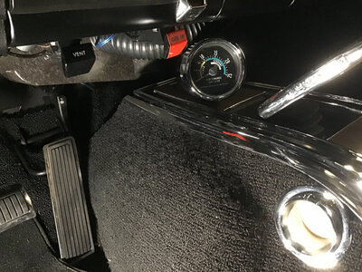

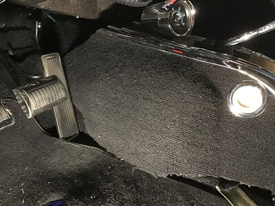

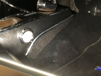

Here are some pics that I hope will help, this is how my car was finished. 978C1389-446B-4E04-B905-5F30B2D5DD69.jpeg2DA7133D-2D25-4E2C-A87E-DBF8A3CAB3CB.jpegA1B136D0-5021-4ECB-B564-B1EDD2C72043.jpeg
7,701
3,241
Thanks HD539. It will help me get it done. I see your throttle pedal is close to the hump also. I had concern about that. :thumbsup2:
