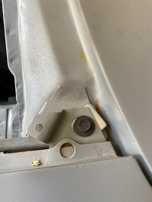

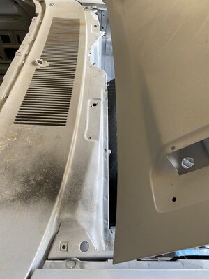

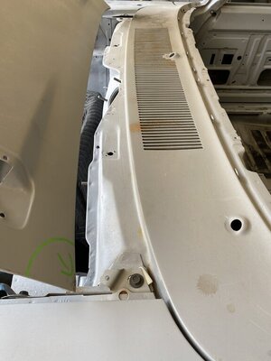

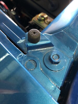

Today paint guy called asking if there should be a bracket on both fenders at the cowl. One picture shows bracket on driver side, passenger side has none. So do I need to fab one up? A picture off another 69 would be great.

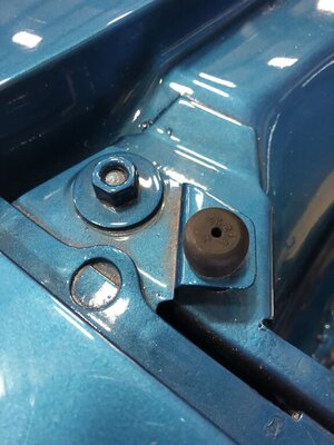

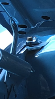

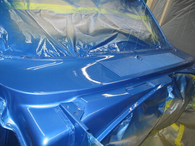

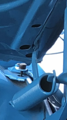

Yes you need to fab a tab because that is where a hood bumper goes on both sides small round rubber bumper

Thanks for the pictures. Strange that was missing. I’m thinking part got lost at disassembly. Actually got one today. That was amazing someone had one they could part with.
