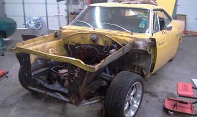

just found the site and thought I'd join. Had my roadrunner for about ten years now and currently being rebuilt because I broke it at the mopar nats last year. anybody have any good advice on how to get the dash pad off? One of those while I am at it jobs is to rewire the car and I need to change out the gauge cluster etc. for this

thank you to everyone for the welcome and advice. I promise pics on the way. just need to pull them together to post.
crank and pistons back in block. just waiting on new cam to finish it back up
