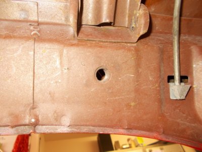

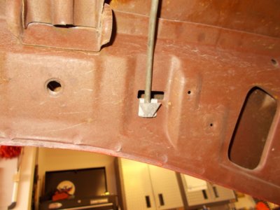

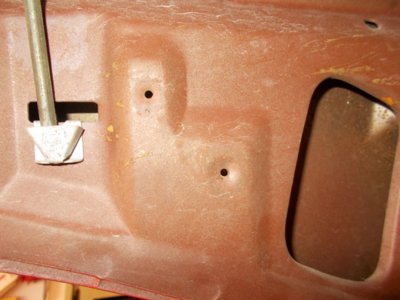

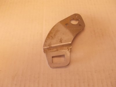

Ok at 30 inches from the sun visor pivot you should feel a large shoulder strap bolt hole. At about 35 inches two screw holes, one for the coat hook and the other for a snap. Then this bracket goes under the visor to clip the belt to when not in use. I might have a couple of spares for a nominal fee LOL

Finally got around to fitting the new belts. Those photos were of great assistance!
That moment though when you're sure its the hole, but are still too scared to punch through the head lining... I must have run back to my computer to check the measurements at least 10 times
