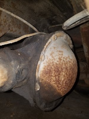

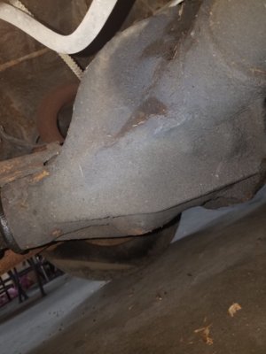

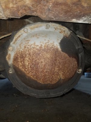

Lately i have been working on a 69 Road Runner for my brother and we recently pulled the engine to freshen it up ... it has i believe an 8.25 rear in it but i look in the 69 service manual for the b body cars and their is nothing mentioned about the 8.25 ... would this have come factory and are their any stampings that might tell me what gear ratio is in it... Please be kind as this is my first Mopar car rebuild.

Ill go and take a pic but i can tell you it has an 10 bolt cober on the back and not a front loader

Looks to me like a 68 8.25
