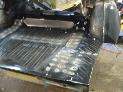

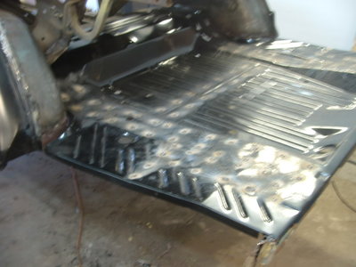

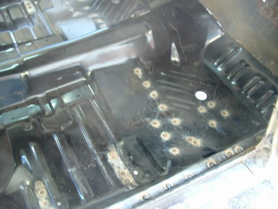

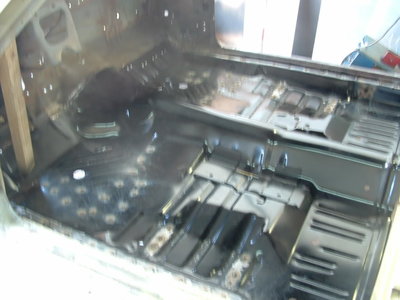

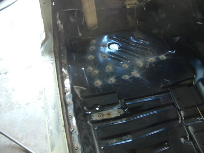

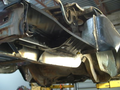

Starting to come together, almost looks like a car!! New floor pans, trunk pan, rear frame rails, leaf spring perches and outer wheel housings.

Is he patching the rear frame rails? Using the safe-t-cap from auto rust technicians?

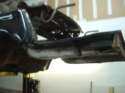

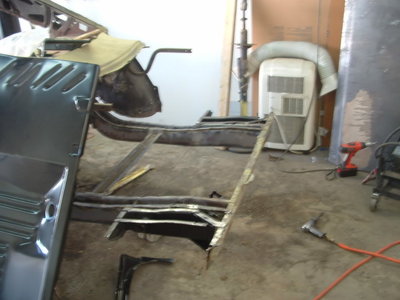

Moparchris, we got new rear frame rails, don't know where he got them from. Just cut them off and welded new ones in. What is saf-t-cap?

Your guy did it the right way. Most of the Safe-t-cap stuff I have seen slips over the rusted part and gets welded in.

Oh, I see. I remember him saying it would be better to get the actual rails. They were pretty far gone, so decided to replace them. At this point, I'm so far into it, I'm just replacing whatever it needs. Just have to postpone retirement for about 30 years. LOL.
