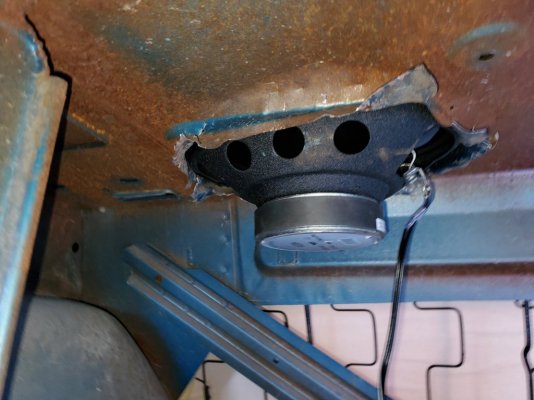

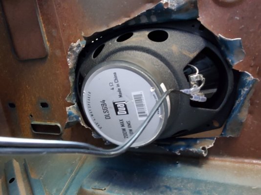

Hi All, does anyone know if the package tray, (the rear speaker deck) on a 69 Road Runner welded in or bolted in? I just discovered that the genius who owned the car before me butchered the speaker openings with snips or something and put the speakers in from the top. The speakers were too big so he totally destroyed them. The whole deck will have to be replaced. Thanks in advance for any knowledge and feedback.

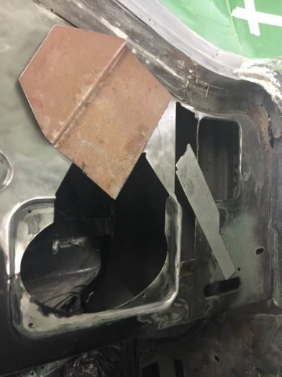

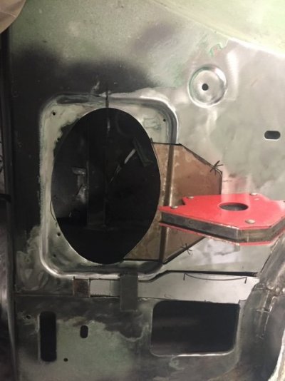

It is welded in. You could cut those out and weld in patches from a doner deck or flat metal and cut to size depending on how original you want it. Nothing easy.

69hemibeep I figured as much. I thought about the cutting the sections out but there are no donor cars in my area. I might have to put some feelers out there.​

looks like holes are still too small. wouldnt take much to pull the speakers and with small cut off wheel resize holes to actually fit and dont need to weld anything.

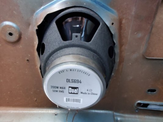

I had a similar problem with speakers in another car a few years back. I ended up making a spacer that sat on the parcel shelf, so the cone of the speaker sits slightly raised, and a smaller section of the cone then sits in line with the tray. The rim of the speaker will usually have tabs (or a complete ring if its a $$$ speaker) that I used to fix the speaker to the spacer.
I also did not want to hack the shelf on that car, so I then siliconed the Spacer - with speaker attached - to the shelf. The silicone helped stop the rattle from the speaker, and was easy enough to remove without too much heartache.
