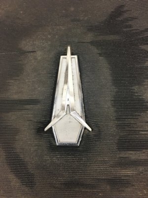

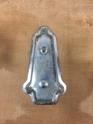

0FEBF860-2225-455B-B507-0BE8ECAEC94F.jpeg 3A8E45E9-5A0F-4300-85B3-B4C55E12B089.jpeg Does anyone have a good way to get these apart without breaking anything?
22,143
2,351
Its been so long ago I don't remember how I did it. I do know I had to tap the teeth back down a bit.
724
I use an ice pick to get into the slot and bend the tabs slightly to allow the head of the pin to come through. Usually have to bend two tabs and they will come apart. And then, as stated above, lightly tap the tabs back down. I have broken a few over the years, but not to many.
