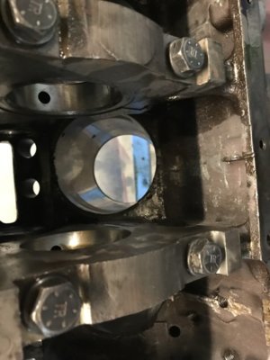

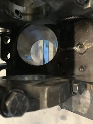

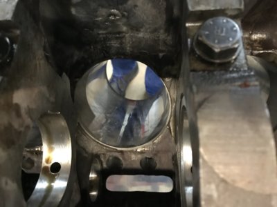

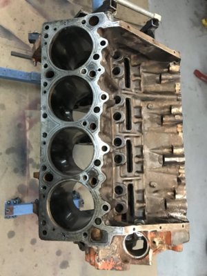

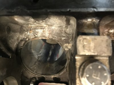

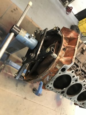

So how many of the cylinders where sleeved. I think that is what I am seeing. Are the jug's true from top to bottom or is their wear. Keep us up on the rebuild. Always good to see what the other guy is doing. :kartman:Where the heck is that beer assistant?????**&^%%
oscar holland
Nov 18, 2018
160
127

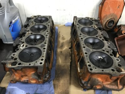

Think something is broken and went it’s one way put in 2 new sleeves will solve this new pistons bore it over sell my kidney to pay the machine guy and i am done........

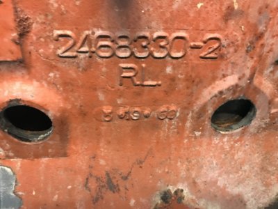

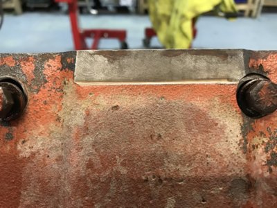

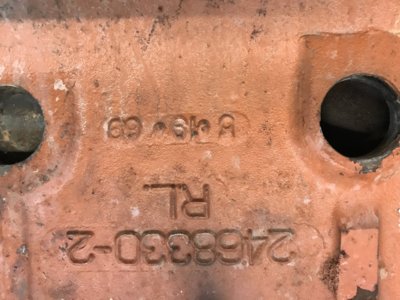

There is no vin nr on my engine and on my trans anyone seen this before?
Production date is in line with build sheet.....
22,141
2,344
It is most likely a replacement block. Most 69 cars got blocks that were cast in 1966 they made way to many of them back then. Any assembly date stamped on the flat near the distributor, that would tell the tale.

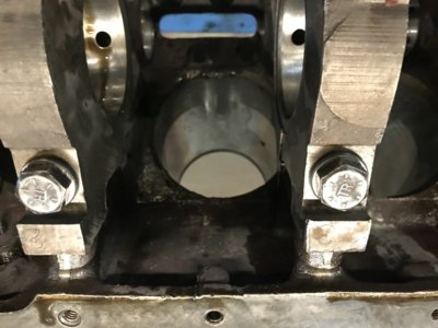

Looks like a good usable piece to me. Was this a running/driving engine before you tore it down? Have pressure checked for any casting issue for leaks. Nothing wrong with having a sleeve or two if they were done correctly. Hell, I have some racing buddies that all 8 holes are sleeved.
oscar holland
Nov 18, 2018
160
127
it runs when it came out but smokes like hell done some pressure testing now looks oke
will have a total rebuild in the coming weeks

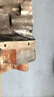

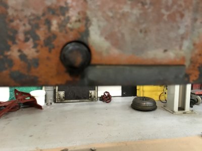

Hello seems to bee some coolant leeks in the block who where badly fixed in the past

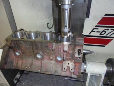

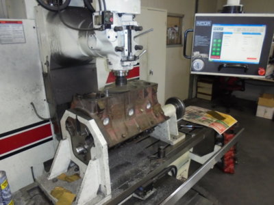

This is fixed now have the new pistons waiting for the machine shop to bore and sleeve

Sounds like your getting it done Oscar. Know you will be glad when it is done. I feel your pain buddy. Every time I turn around finding more things I did not think I would have to buy. Keep at it and it will all work out. :thumbsup2:
