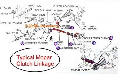

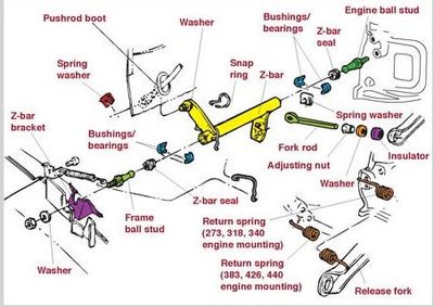

Oh hell, I know it's a dumb question, but I'm not so familiar with manual trannies. Anyone got photos/diagrams on what linkage parts are needed on the 4 speed setup? Trying to figure out if I have all the needed/correct parts before I get that far along. Any photos/help with be appreciated.

check the tech section, the FSM should show waht you need.
