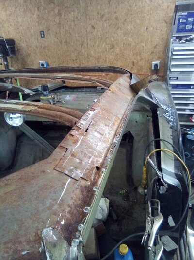

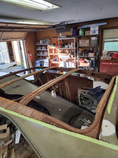

After evaluating the roof on my 70 I've decided it will be easier to reskin the roof than fix all of the damage (looks like a tree branch fell on it) I was looking at the drip rails, I took a wire brush to them and found that there is something that resembles body filler. I have never reskinned a Roadrunner so I guess I'm asking if anyone has noticed the filler between the roof and the drip rails? Also has anyone been able to save the factory drip rails or did you have replace them? I'm trying to save the $250.00

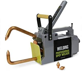

Yes seam sealer like 69Hemie stated. Don't think you can save those drip rail's I just got new ones too do mine. Do you have a spot welder from Habor freight they work grate in that area. Also around the back window and front brow for wind shield pinch weld. Thought I would not buy one but it did come in handy in places. 61CmP81GYWL._AC_UL320_.jpg
7,696
3,231
If you watch Pete my friend Pete on SWRNC U tube. He show's what to use between the roof rails and roof. It was a calk instead of seam sealer. The roof I got from AMD looked straight out of the box but after applying it to the car found had low and high spot's. Not too bad but will have to block sand it and get it straight . Good to see you saved some money just to put some where else. Keep us informed on the progress. Russ.

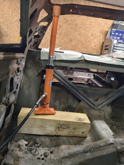

I'm working on the roof frame. When the tree fell on it the frame crushed down on the right rear corner. It is about 3/4 of an inch lower. I'm going to use my porta power and work it back into place. I'm going to put cribbing under the car so I'm pushing up on the frame and not down on the floor. I expect some minor dents, but this is the best one I've seen. I watch my friend Pete all the time, I love it when he goes off.

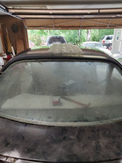

Make sure the rear glass and trim fits
Yup, I went to the shed and pulled out the glass. I think I'll take a little time and clean it LOL
7,696
3,231
Ordered stuff off E bay and other places to clean the scratches out of my glass. Watched U tube videos of how to clean glass. Did not like the results in the end. As most may know bought a new glass form AMD and put it in the car it was tight and after installing it two hours later it shattered. I was hart broken of cores. But looked a head at what to do. So had to have a Custome one made. It was costly but wanted to finish the car. I have since thought about what could have, I had done wrong so may have filled the pinch weld too much to smooth out the over lapping metal. Even though I keep checking it with the old window. Won't never know for sure now that the car is finished. Just going to drive it and show it off. Looking good on your end and hope you get yours's done soon. 5 and a half year in my car from start to finish and loads of money. :beep:

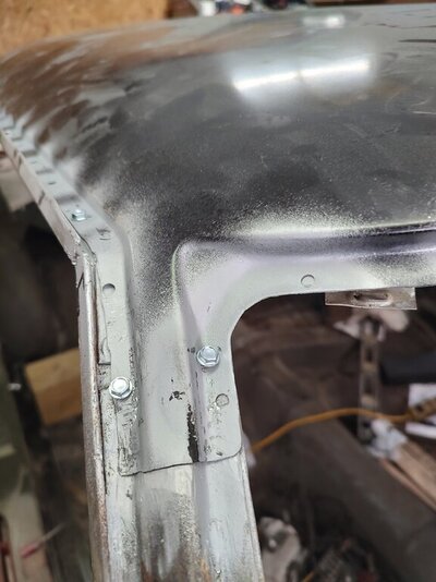

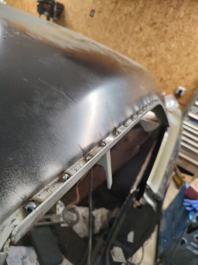

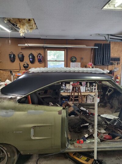

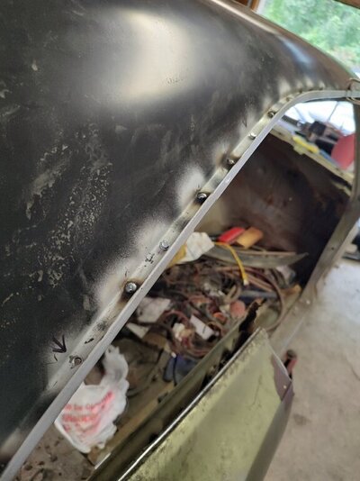

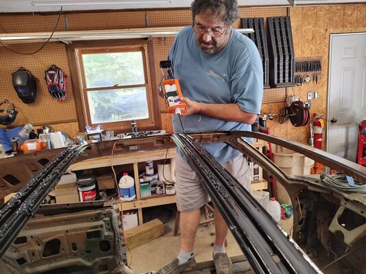

I've got the roof mostly fitted. I'm just waiting on the 3M NVH Applicator Gun. I had a little trouble with the "A" pilar extensions but was able to work them into shape.
