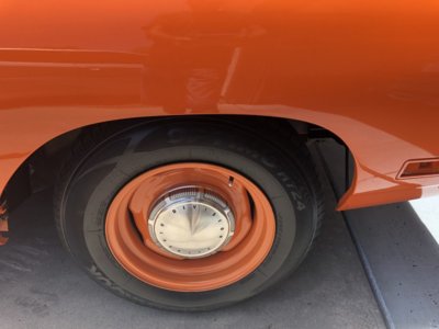

  16. john visconti
    john visconti Active Member
    Messages:
    44
    Likes Received:
    Joined:
    May 4, 2019
