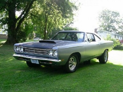

Dave's car is now my favorite color. Primer. Hahaha. I have been calling his body guy and feeding him money to not finish Dave's car so it'll stay in primer.
tell ya what Chris, I'd be Ok staying in primer, but tell my body guy to put some nice paint on The Boss's Ghia! You know, If Momma ain't happy....
