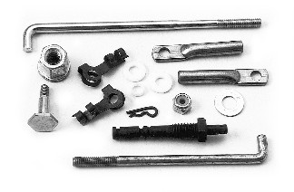

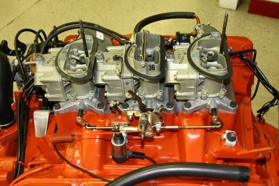

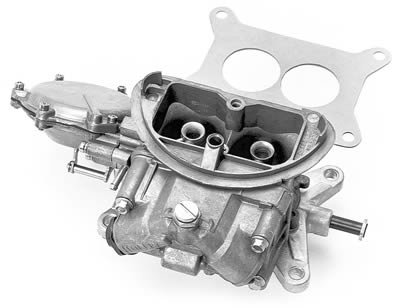

don't have the car in front of me so I will have to ask, what is the diameter of the hole in the outboard carb where the linkage goes at the end of the throttle shaft?
Budnicks
Nov 9, 2013
549
26
Sonora Ca.
If I understand you correctly... 3/32"s IIRC if your talking about the little hole for the linkage rod on the ecliptic shaped flat end plate @ the end of the throttle shaft, where the 90* linkage bend goes into & the little clip goes over it & on the rod... I would have to check latter, to be 100% sure, if need be
