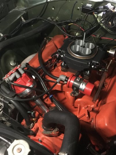

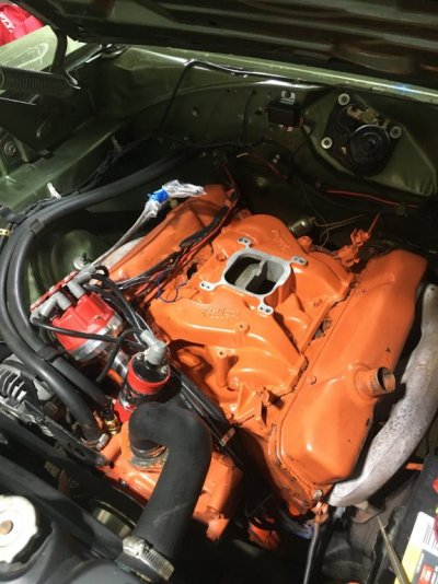

I would be curious as to the nature of the problems. Looking into efi for the ModTop. I thought it would be the easiest and completely reversible. Put the carb back on and reroute the fuel line from the original pump. Making it an easy bolt on conversion.
22,143
2,351
He had an early Fitech when they were having all kinds of problems, not sure what they are like now but he had ECU problems and loss of fuel pressure issues.
V.R.D
Oct 27, 2020
479
566
florida
Yeah, zero interest in that. Wanting to use original air cleaner to maintain the factory look.
they have the 4150 style so you can use the factory air cleaner if you looked at there systems
