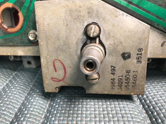

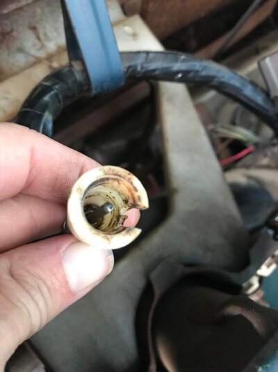

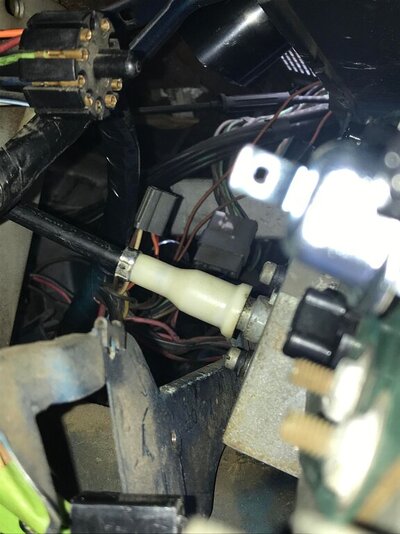

my speedometer was working (the only thing working on my dash). i just refurbished my entire instrument cluster and everything is working great.......except now the speedometer doesn't work? it sems im plugging it in as far as it will go, feels like a snug fit. what did i do wrong???
quikbird
3,233
1,028
Sarasota, florida
check the other end at the tranny. this cable is a little iffy on being long enough and seating one end real well pulls out the other. Dont ask how many times I was under the car fiddling with it till i finally got it right
7,705
That is what I did before hooking the cable up to the trannie. Taped it up till I got it down to the transmission. So, it would not slip out.
