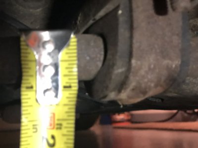

Anyone know the standard sway bar bushing size when buying replacements?
I do no have a micrometer? i think thatsis what its called,
so i tried measuring with a reg tape measure. lol
came up with 13/16?
