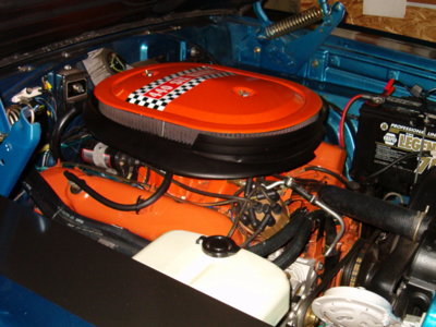

I don't start my 440 during the winter but when I do in the spring it spins over a bit until gas gets up to the carbs. Some say to put some gas into carb for a faster start, But I thought that a longer crank over would get the oil pumped up be fore it starts, Any Thoughts on this !!!
