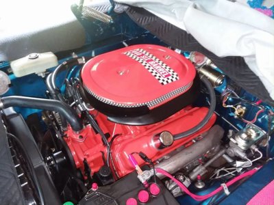

Will my stock steel hood fit with the 6BBL set up34507497_1685379598194474_2930948423672659968_n.jpg

there used to be a guy on FBBO with a '69 GTX running a Six Barrel with a steel hood.

Now that I know the steel hood will work, I will be installing this weekend, I do not expect any issues, but if there are some left or right spacing issues how do you adjust this ? forward and up and down Hight
are easy. not sure about left or right
Thanks Tom C.
7,705
I did not see any spacer's behind the Hinge to the inner fender. Think where the hinge bolt's to the hood should be some adjustment. Left right back and front. Are you going to cut it and put the air grabber in. Or just leave it a sleeper.
